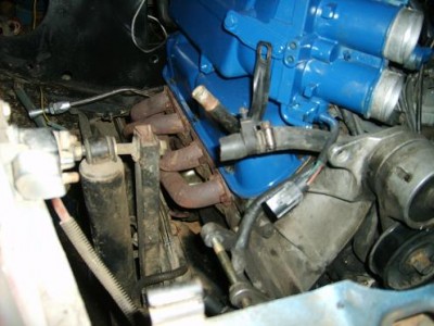

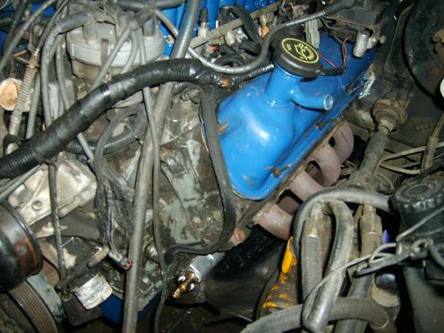

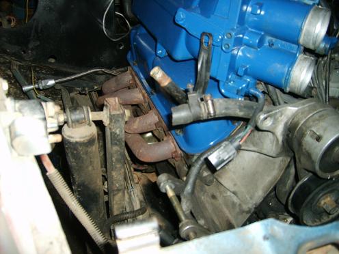

i know a few guys that use the stock 2.9 mounts, and make an adapter plate to bolt them to the 302 block. They have had better luck with them staying together than most v-8 mounts. It also lets you set the block right where you want it.
Dreded
Posts: 182
Re: Engine mounts
Post by Dreded »
I just used flat pieces of metal with holes drilled in correct places, on the stock 2.9 mounts, it holds up great and engine sits perfectly I will see if I can locate a picture
