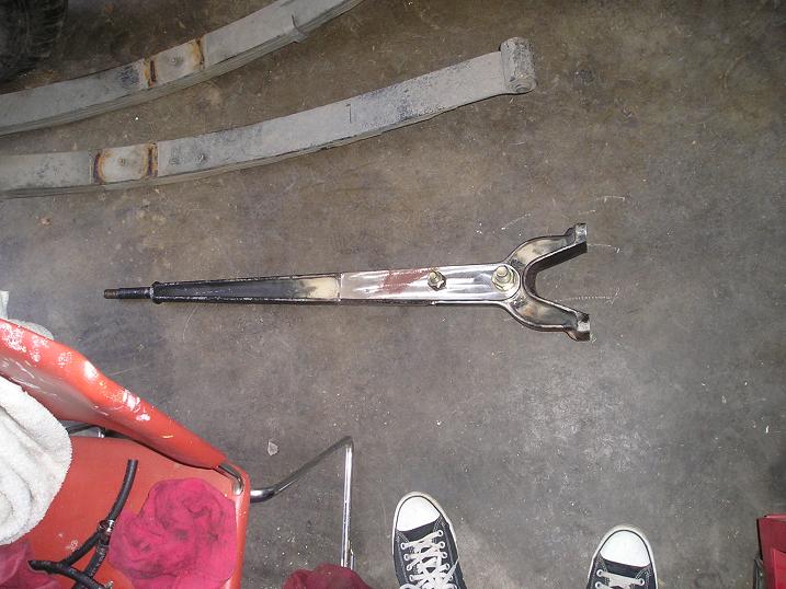

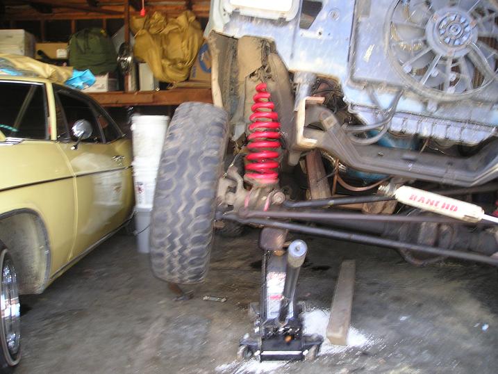

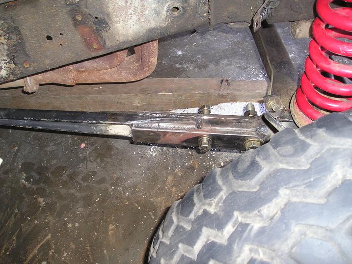

i went to L.A friday and installed my writed arm. dose'nt seem to have changed the flex any. i have 2 question's about the wristed arm.
1. when flexting what way should the arm wrist?
2. do i need to put any lube between the moving surfaces?
here is a pic of arm installed and one of the arm piviting upward after axle flex.

Arm looks great!
It's working. You can't really tell so much with a floor jack. The arm pivots both directions. You need to ramp it. Also, you'll gain much more droop than compression. I'm sure your springs are too stiff. The springs and bushings will break in once you start wheelin it.
When you put the shock on, don't make the mount too tight on the shock bushing, and make sure the arm will move an equal amount in both directions.
No worries, wristed arms are proven.

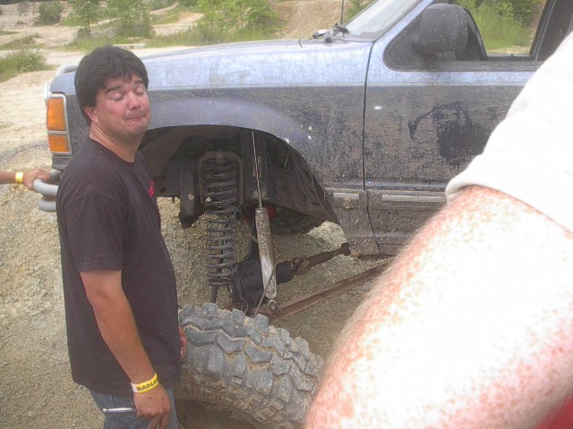

wristed arms
holy crap that's alot of wrist. how is you rig flexing, or is it sitting on all 4 with that amount of wrist?

i will try and find the pic of the sploder and get it up here, its not my rig, but one i wheel with.
