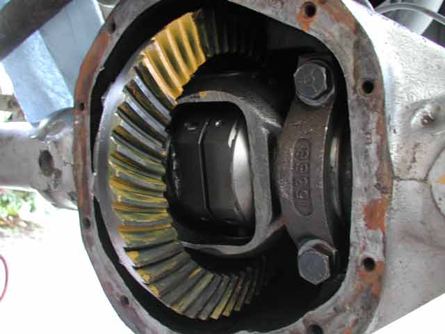

Are all d44 R&Ps the same? Or are the cut different? This dude doesnt say and hasnt responded to my question yet. http://cgi.ebay.com/ebaymotors/ws/eBayI ... 7913752941
Posts: 2232
No, on a high pinion axle, the gears are cut in the reverse direction. Assuming it's the actual gears in the picture, they are low pinion gears.
My gears
you also need to make sure you have the right carrier too. the carrier for a 3.50 and a 4.10 or higher are different.
