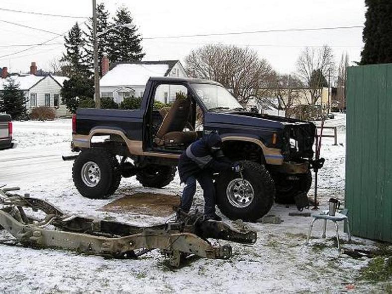

i did a body swap on my bII i took my 87 broncoII and placed it on top of my 79 bronco chasis. it was cheaper for me to go that route becuz i already had a lifted 79 bronco that had some body damage from the tight trail's in Washington. if fullsize is what you want and you have to build on the cheap then i would say that making the coil bucket spacer's and radius arm spacer's would be better for you. you alway's can find a fullsize d44 with removable wedges later or just stick with what you build. there were a couple of rig over ar the ranger station site. one ran leaf's the other ran coil bucket spacers and there are alot that ran with eb's i did alot of research and talk with a couple of the guy's that ran those set up's. the one truck with the coil bucket's was sold so i dont know if it's over there still.

here is what i did.
Posts: 2232
I thought I was the only one dumb enough to work outside in the snow. I remember that's when we had that cold snap last year....
nope :D i'll tell you what though it's better than working in 103* with no shade.
