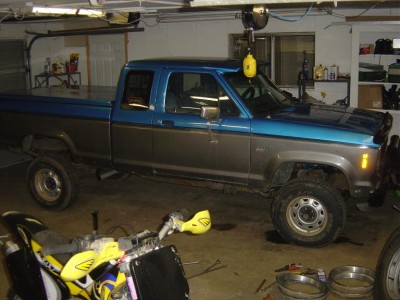

has anyone ever done f150 coils on an 88 supercab 4x4 ranger?
how much lift did u get?
any modifications?
I hear that all u gotta do i bend the 2 outer tabs outward so the coil fits in.??
heres a pic of my truck
The tabs are on the inside of the coil perch. If you are to do any lifting with springs you will need the drop brackets as well to make it look and ride right. I believe I gained 3 inches with the f-150 cil buckets. Ypu can get probably 3 more with the stock bucket. That means ypu will need 6 inch lift brackets or so. Unless ypu are putting the weight of a bigger motor on the springs, it probably isn't a good idea. Ypu will end up with what an old guy doesn't hear to much anymore... to stiff ;)
