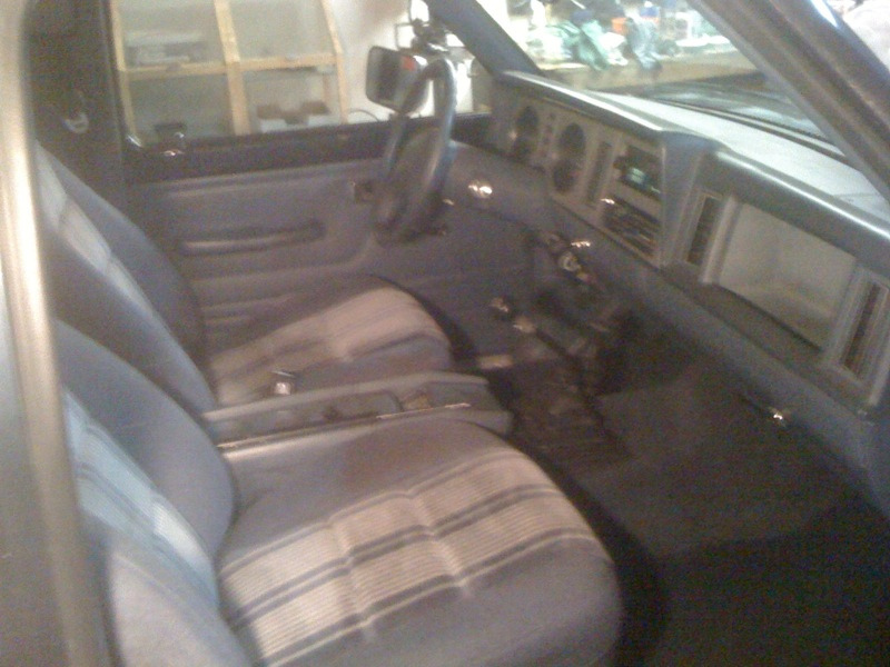

The Bronco's body is straight, with some of the paint chipped or peeling in sections. I plan to just touch up areas with spray paint for now. All of the glass is good, but the doors need new window channel felt because they rattle a bit. Also, I had to remove the headliner because it was completely unglued from the plastic board, and it was raining glue/foam dandruff down on me every time I drove it. I kinda like it without the head liner though. It gives me a place to stick decals on. Other than the headliner, the interior was in great shape, with just a minor rip on the drivers seat, which I'll sew shut. The rear cargo area carpet was also pulled, but I plan to rhino line that area.
