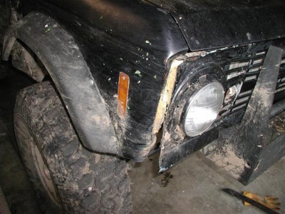

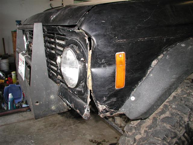

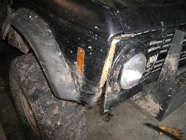

Depends on how nice you want it. Mines not very nice, but it didn't take me very long either
Getting pretty lines won't be easy unless you plan on working the grill into the fenders....which I avoided because I wanted to be able to remove my fenders easily.
I lack body fab skillz, but a little tip from Wilber is expanding foam
Thanks to wilber, my bronco is about 90% expanding foam now
I can't really offer much advice other than start hacking.

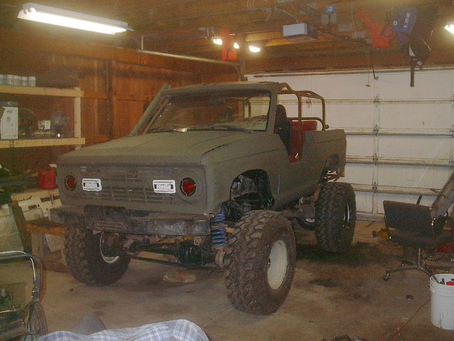

Yep, round headlights are pretty
I hated those stupid plastic grills. You look at them wrong and they blow into pieces.
The main reason I did the swap was I planned on building a new radiator core support. Since the headlights mount in the EB grill, that would free up some space for my radiator. I still haven't gotten around to that

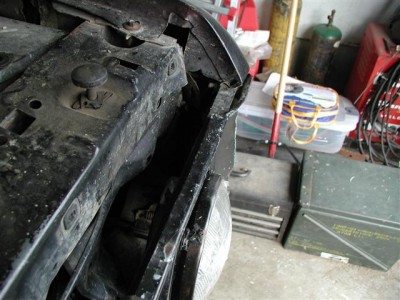

So as I mentioned before, I ran a piece of angle between the fenders, then mounted the grill to that. I think that makes a good start.
Around the fenders, my grill is just a rough cut. With a little patients, I think you could hammer/weld/fab so the grill would mate up to the fender nicely, then run some screws into the fender or something. I might try to at least get some duct tape on there
My bronco is a trail rig, so as you can tell, I'm not too concerned with looks.

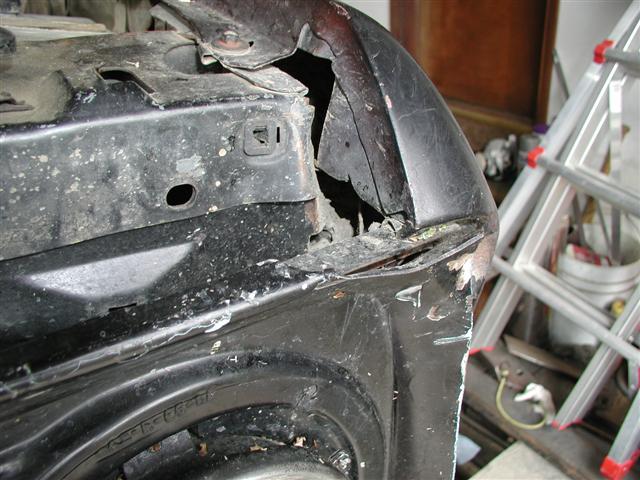

I'm going to try to roll a lip on the outer edge, and see if I can attach the grill right to the sheetmetal the curls behind the stock grill ('87 front end).
Attach with a half dozen security screws along the sides, then fab up a center brace just for a little stability.
Either that or fold a new lip that would reside behind the fender, and run the screws from the fender into the grill (does that make sense?)

The only clearance issues that I recall were the hood latch, and center brace for the stock grill. I trimmed up the hood latch bent the center brace out of the way. I planned on building a new core support, and adding a few spots for the grill to attach. Stilll might happen......someday.
